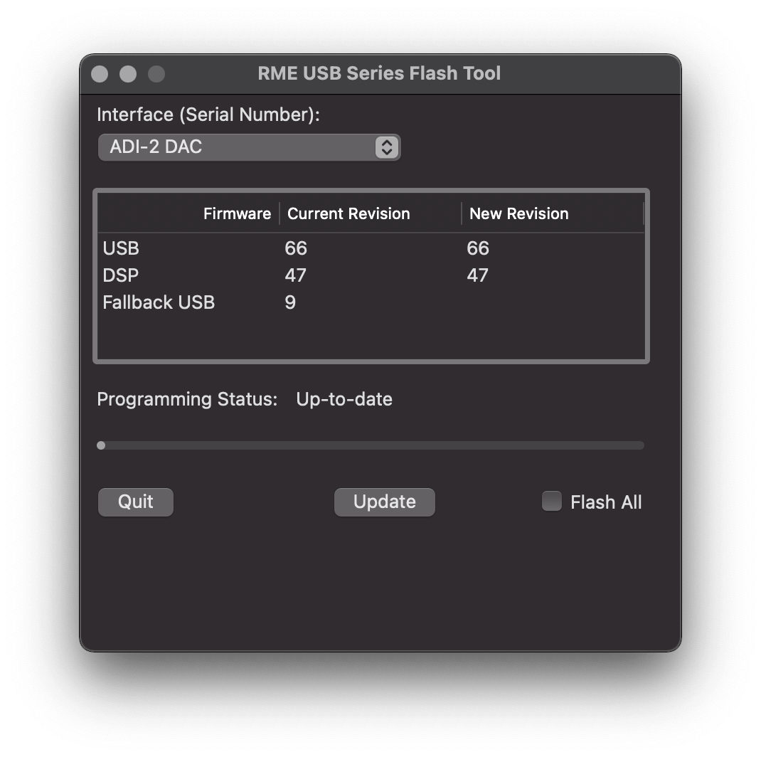

After the download, connect your ADI-2 DAC FS with your computer via a USB cable, unpack the zip folder and start the Flash Update Tool. If you get security warnings, click on „open anyways“. In the dialog screen you can see the current firmware version of your ADI-2 DAC and the new revision.
Under „Programming Status“ you can also check the recommended action:
Now you are finished! |
