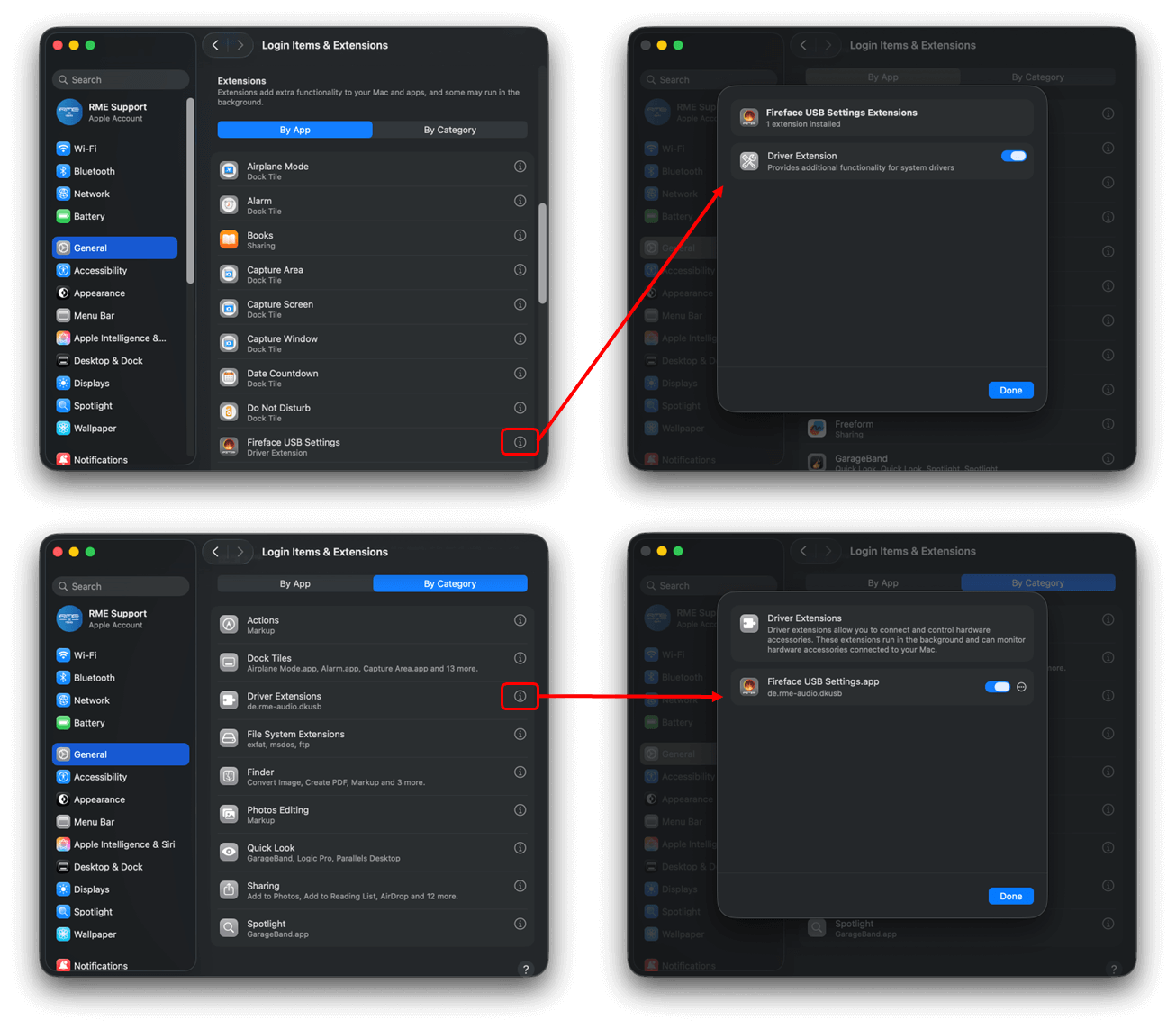

Login Items & Extensions (DriverKit) macOS Tahoe/Golden Gate
Login Items & Extensions (DriverKit) macOS Sequoia

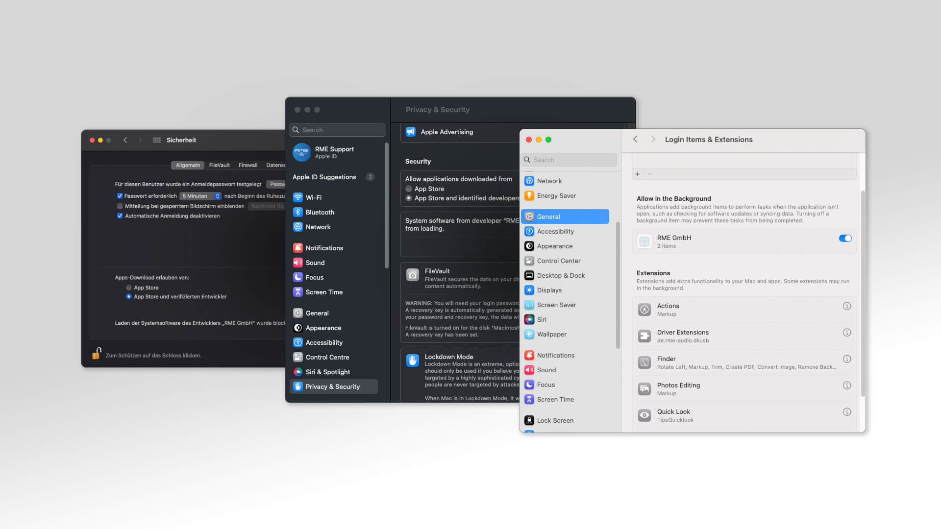

Privacy & Security (Kernel Extensions) on Sequoia/Tahoe/Golden Gate
Privacy & Settings under macOS Ventura / Sonoma
Security settings under macOS Big Sur & Monterey

    Before the reboot for finishing the driver installation open System Preferences, Security & Privacy, tab General. There should be a grey „Allow“ button in the right lower area. Click the unlock symbol first, then confirm using the RME GmbH extension.
    Before the reboot for finishing the driver installation open System Preferences, Privacy & Security, "Allow applications downloaded from" Click the Allow button, then confirm using the RME GmbH extension.
    macOS Sequoia
    Before the reboot for finishing the driver installation open System Preferences, General, Login Items & Extensions. In the section Allow in the Background make sure the RME GmbH switch is ON. Then scroll down to section Extensions, entry Driver Extensions. Click on the exclamation mark to the right. In the new dialog activate the Fireface USB Settings.
    macOS Tahoe / Golden Gate
    Before the reboot for finishing the driver installation open System Preferences, General, Login Items & Extensions. In the section App Background activity make sure the RME GmbH switch is ON. Then scroll down to section Extensions, click on the tab By App, locate the entry Fireface USB Settings. Click on the exclamation mark to the right. In the new dialog activate the Fireface USB Settings (or HDSPe Settings).
